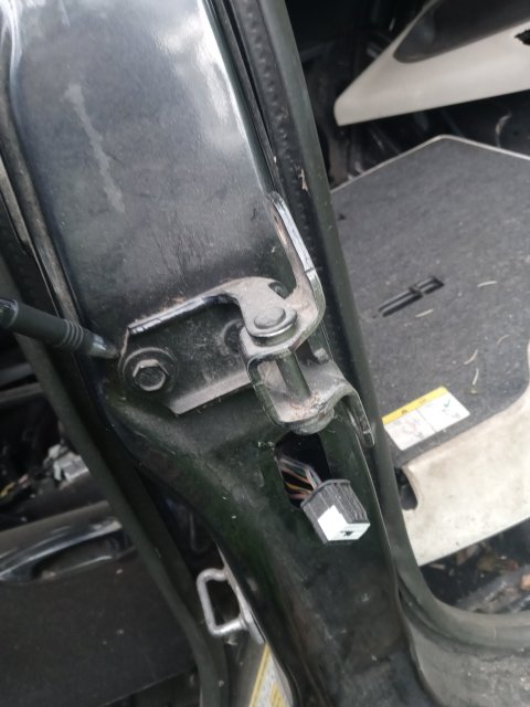

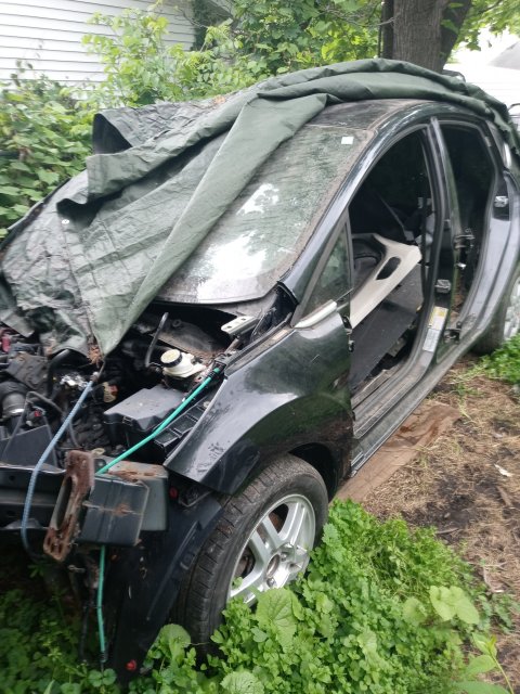

"Body Control Module" bad or bad connection? When the door was replaced, did it also get the hinges? This is where all the adjustment is, except for the striker. Being a repaired car, can you see any shims under the Hinge to B post or hinge to door shell? Or maybe some shims or washers under the bolts holding the striker in position? There shouldn't be anything like that. They should be flush to the vehicle. Like the ones clinging to this wrecked fiesta i am slowly picking clean. 20220610_172249.jpg 20220610_172232.jpg 20220610_173835.jpg

"Body Control Module" bad or bad connection? When the door was replaced, did it also get the hinges? This is where all the adjustment is, except for the striker. Being a repaired car, can you see any shims under the Hinge to B post or hinge to door shell? Or maybe some shims or washers under the bolts holding the striker in position? There shouldn't be anything like that. They should be flush to the vehicle. Like the ones clinging to this wrecked fiesta i am slowly picking clean. View attachment 6542 View attachment 6543 View attachment 6545

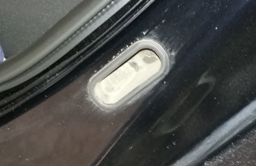

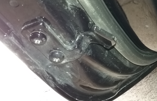

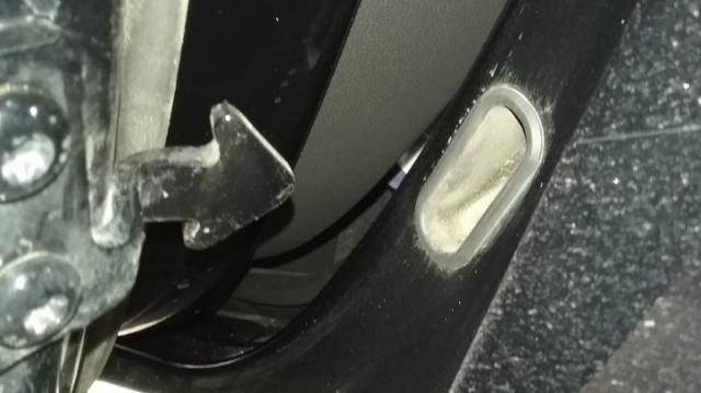

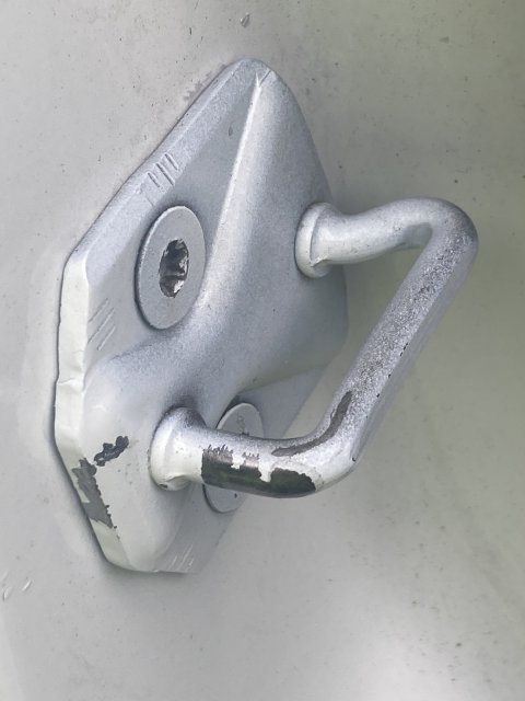

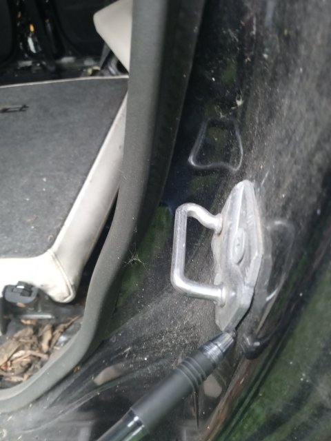

You also may have a "Devils fork" it is an alignment pin/socket so the door closes.
Located on the bottom of the door - there is an oblong hole...
And this little "fork"
That as you close the rear doors, they match up...
like this...
So, check the alignment of these two - I believe it works a sensor so this may have a influence on your issue.
like this...

This "fork" is for crash protection.
From the conversations I've had with others - and only reason why it came up was due to an injury - someone got into an accident with one of these (Fiestas) and one of the rear doors that fork was "popped" outwards - it is "our thoughts" (being the group I discussed this with including the accident "victim") was they are to engage when a side or rear impact can force the door to pop ajar and the tines then catch to prevent the occupants from slipping under and falling out - the fork just keeps the door aligned and if enough force is applied from the accident, the fork is forced into the door jamb - the springback from impact does not let the door open.
So, if it doesn't have this - then the latch wiriing to show it's locked may be damaged or the BCM is faulty.

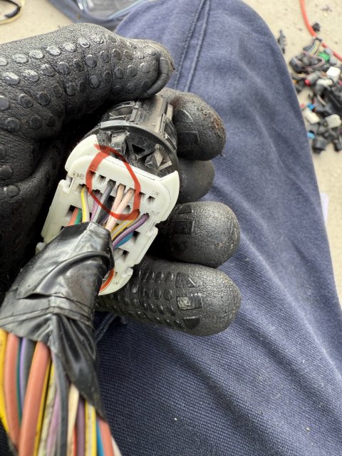

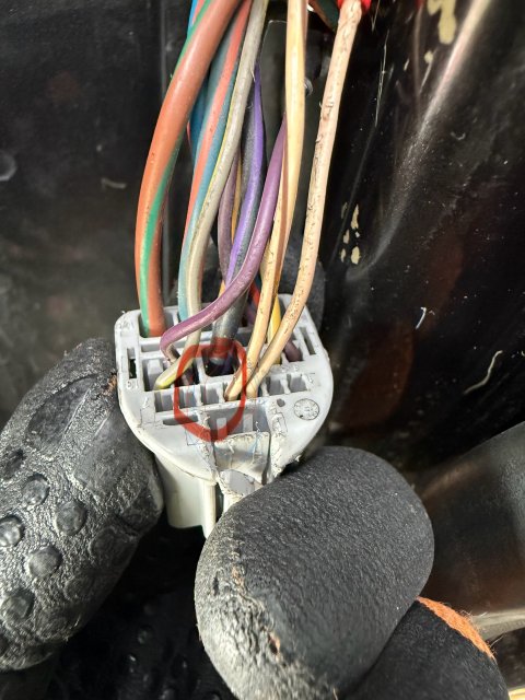

Was having issues with driver door ajar for 9 years. Just fixed the issue….
my driver door wiring harness has the ground from the door latch plugged into the connector here.after ohming it out and hearing no buzz I started chasing it down….
The body side of the harness is missing the effing ground wire. wtf ford!!!
Added the ground here and voila*** no more door ajar issue. Dome lights are getting plugged in now. 😫 😫 😫 9 years of driving this mfer around like this. Finally. And a big eff you to ford for this ish qc ✅
