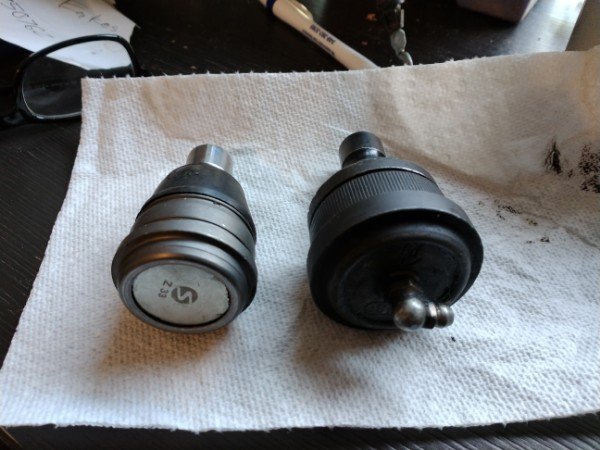

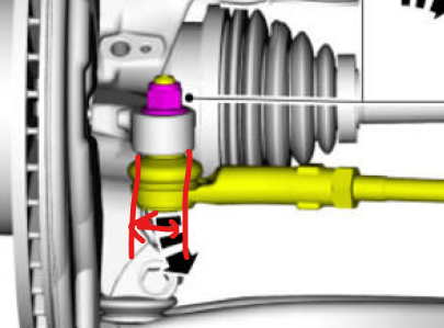

the ball joint that is in the car is about 2" in diameter but all the parts stores piece is about 1 5/8" - any ideas what is going on - could someone have switched out the control arm?? thanks
977
Well, without going into a bunch of research, if the part store insists it's a direct replacement it probably is. I also notice the old one has a grease zirk (that would explain why the body is bigger, it retains grease & needs re-greasing x-number of miles), where the new one is sealed and self-lubricating. If you are concerned that interference OD on the joint is different than the ID on of the control arm, then yes, that is an issue.

Yep the control arm must be from different year or even model. The hole in it is 3/8 bigger than ball joint. Hopefully some knows what the arm came off of. Thanks
When I was searching for ball joints that came with a grease zerk i found several of them that had a beefy socket. But absolutely none with a zerk fitting. Any brand marks on the zerked version?

might be a MK - zerk I dont care about - just the dia being about 2" thanks

But this is not the steering linkage but the control arm ball joint.
Yes. I understand. Is the non matching part causing an issue? My point was "bigger" is not generally a problem.
I would have to guess that you have an aftermarket control arm that has a non stock sized ball joint. I cant recall ever seeing a replacement part that didn't very closely copy the original. Its not a big deal to just change it for one that is closer to the O.E. part.

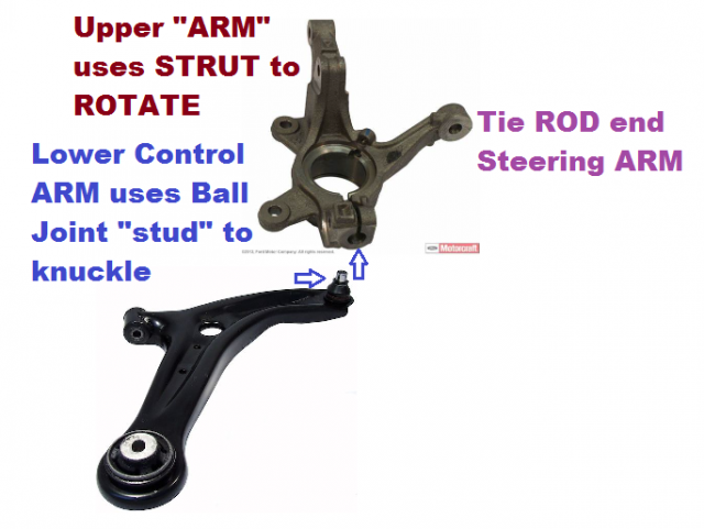

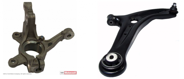

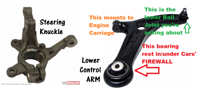

I see your problem (I think...)
To help label...

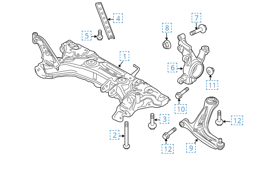

You might need a new control ARM... the lower Ball joint is the control ARM itself - it's a one-piece unit...
A video here can help with that...
The part number for the ARMs are...
Lower Control Arm - Ford (BE8Z3078C) - RIGHT
Lower Control Arm - Ford (BE8Z3079C) - LEFT
#13
IF you stomach the above, the bigger question is why you have such a different size is beyond me except to have replaced the knuckle with a different one from another vehicle. Or if not replaced, they MODIFIED the OEM Control ARM to fit this new ball joint that is now why your back in the shop later.
If your car has got a lot of miles, then this would explain it - but the control arm itself is rather unique to the vehicle. So, it's Ball Joint is part of the arm.
And why are they showing you a part that is integral with the lower arm?
Although you can change it yourself - for the better way is to REPLACE the arm with a new one considering Safety and age - it is better to replace the whole arm than to try and replace the ball joint for as this is reawakening a light bulb going off inside my head, this may mean they "reamed" out the old and put in a different one and you're better off just replacing the whole arm.
Why? You get the new ball joint - but if they did this to both sides of the car, then you'll have to replace both control arms to keep symmetry.

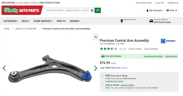

Thread Starter #17
ok so tracked it down - aftermarket supplier Precision Engineering makes it (pn 5CB40186) and sold by Oreilly - and only comes with ball joint installed - not great news $ wise but now I know -
#18
Sorry to see you get dragged thru this agony - but it's the whole arm.
So, to know this - at least, it's the WHOLE kit-and-kaboodle
Thats not a bad price either.​
