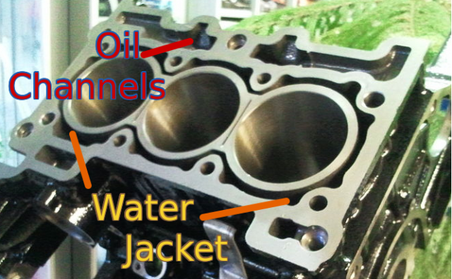

  • Much of the reason why I say the above is due to the Turbo that is in these motors. I have witnessed several events requiring a much bigger rebuild than a simple tune-up which they were led to believe was needing to be done.
  • Partly the problem with gasket failure is from the "more than enough" Air and fuel charge the turbo puts into each cylinder and the amount of tensile strength the block, cylinder head and gaskets involved - provide against that combustion pressure. Looking back further as to the cause is from the needs of the Driver in the conditions they face in everyday driving may require more use of the Turbo than what was expected.
  • GDi models have had to overcome the excessive air pressures the compression stroke does and still be able to dispense the fuel charge into the cylinder so as to fire it. To think of this process as the injector nozzle and the fuel pressure required behind it - does the condition become more clear.
  • So with the above in mind the excessive pressure caused by that increased charge passed into each cylinder - the gaskets are the most weakest link in the process. Blow-by gasses can spill into both the coolant and the crankcase by rings - oil channels and the coolant jacket - its from that distortion of the seal for the cylinder head, is how this can happen.

As another hint, look and locate the cylinder head bolts in the motor - and note how the jacket and sleeves "float"
