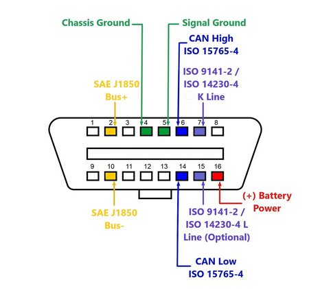

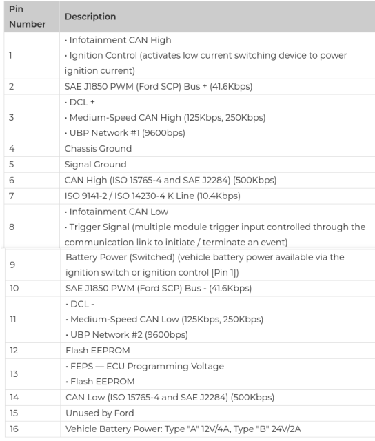

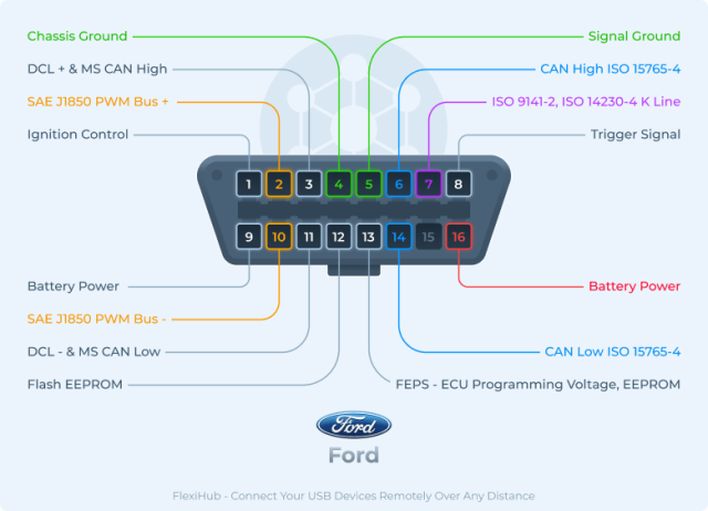

To help with this - I've had Air-Bag codes set due to someone messing around with the kick panel under the drivers seat - either I get soaked for $1,000 bill in labor and parts to replace something they broke or contend with the error - I had to find a fix on my own and use a shorting stub on the DTC connector Reset-Data pin on the various Engine, ABS, and SRS connection points to clear codes that wouldn't otherwise clear.
If you notice there is no True RESET pin. This is a story for later. For in various systems - including the Fiestas' you have to short pins to ground to clear a code. As what a simpler DTC code scanner will attempt to do. But remember if you're not careful, you can FLASH a code into the system and require a Service call to a dealer to get this resolved. As had been seen on other Fleet vehicles others tried to fix on their own.
An example...
This is coming from Ford and Flexhub - as public domain being searchable.
