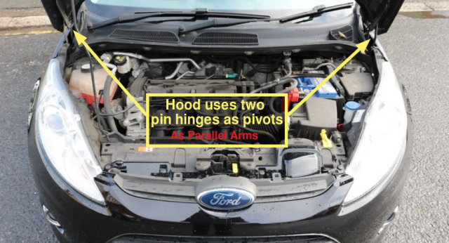

So you know, as you locate the problem. There may be problems with the rear pin hinges, there are two on each side, that help lift and tilt the bonnet (hood) so it can be lifted up and stay clear of wipers being to it's rear - being where the windshield and the wiper arms are - so it can lift over above and rotate the hood so it can get propped up...
So as you work on this, be sure to watch out for a pinch point on the rear of the bonnet so that then you're lifting, you may want to help "lift" the rear of the bonnet up; to allow those two pins on each side (parallel lift to allow the bonnet to rise up to clear the wipers and their arms) to get some space in-between them so they can allow the hood to continue to pivot up and open for you.
