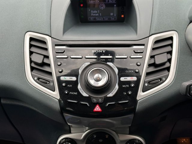

I have a 2010 Fiesta Ti with the radio and Sync system per the photo here:
Overnight and without any other changes having been made to anything, the bluetooth and USB no longer work at all (and just prior, I noticed that the steering wheel controls for skipping music tracks weren't working properly either, and the cruise control was erratic in terms of whether it actually turned on).
Going into the settings on Sync no longers offers me the option of turning the bluetooth on or off, and my iPhone doesn't detect the car at all.
I've replaced the fuses for audio and bluetooth in the glovebox fuse box, and also disconnected the car battery and reconnected after 30 minutes in the hope of a "hard reset" to Sync, but no change.
Is there a way of forcing a reset somehow? I've tried holding down various combos of power/volume buttons but nothing happens.
Any advice greatly appreciated! Driving without music is one thing, but without the satnav on the phone is something else all together.
Many thanks!
This looks like more of a SYNC unit failure - where the SYNC module either has lost connection - or fuse blown (you checked at passenger side, but did you look for one in the Engine compartment?) or there is damage to the wiring and Sync is affected.
The SYNC unit by your description is not telling the Stereo (Radio CD) unit anything anymore so the Front Console display doesn't show any available commands because there is no communication with the unit (Sync) that pipes it thru.
So the SYNC unit has quit working - everything else is running on last known settings.

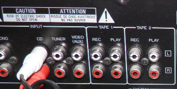

The older days of component systems used a "tape monitor" loop - it allows you to insert specific components to help process the analog audio thru the Stereos Line-input and output level - so the system can add flexibility to let you hear not only the PHONO or AM/FM Stereo - it allows you to add in Reel-to-reel onto Cassette and 8-track or even use imaging processing like dBX and Omnisonic audio processors to make the music and the musician vocals appear live and in-position as if you were sitting right in their studio with them.
