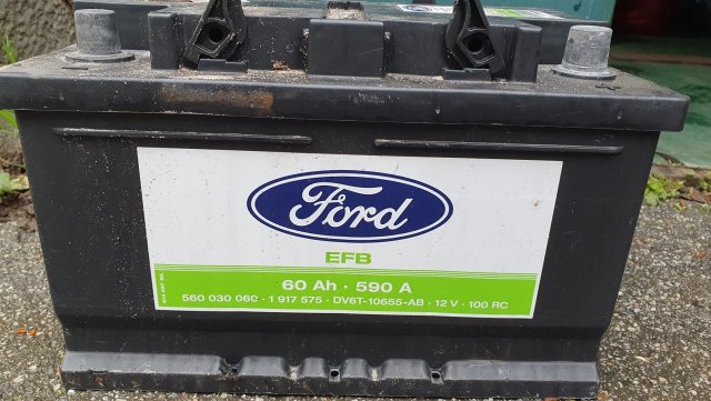

Battery is OEM Ford for this car EFB battery good condition, proper SOC and SOH after DTC U0120 repair. No issues during cranking, start/stop works fine now.

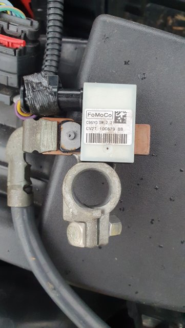

BMS has 2 wires, violet is LIN and Yellow is 12V from +battery pole going through 3A fuse and this voltage comes to BMS connector.

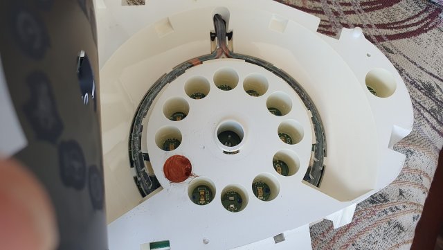

Issue resolved. I suspected that somebody did some stupidity on cluster itself and there it is. He put silicone into the hole where battery led resides and completely glued and covered SMD LED.
It was hard to remove all silicone without damaging led itself, but I managed to do it carefully.
