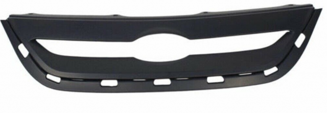

They raised the height of the crash absorber part, so we don't have a "Full Grille" as if it were the earlier models. Instead, we have the "Grille", but it is missing the bottom half of the ventilation it's blackout trim - it covers up the crash brace.
Example 2011 - 2013
AE8Z-8200-KAPTM

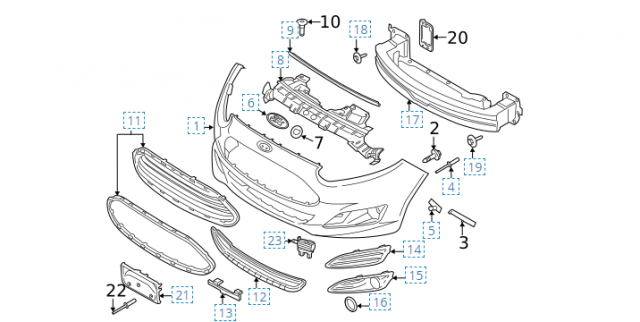

Gave USA this...
Totally redesigned - #17 is that adapted Crash Member
To help FORD maintain 5-Star crash testing.
So, they totally did away with the more esoteric and ergonomic and aerodynamic front piece and went with a grille design that tends to "cover" the redesigned front crash member rebuild that took over from 2014 on...

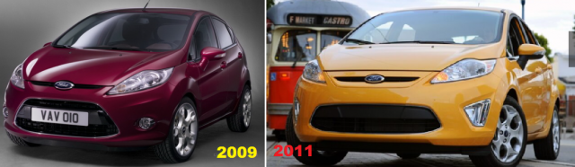

Here's a Side By Side...
The hood made a "seamless" mesh with the front piece in 2009 - but in 2011 - they went with an Insert - with the Hood still same shape and meets in the same area - but the bumper/crash members were changed during these production years. Round Fogs were replaced with Triangular inserts - which they reverted back to rounds in 2013 more in line with Ford Focus rounds with "cutout" trim - to name just a couple - but either way, the "Bumper skirt" is different - and the Hood's "Notch for the Emblem" is evident in the 09, but not in the 11' onwards.
