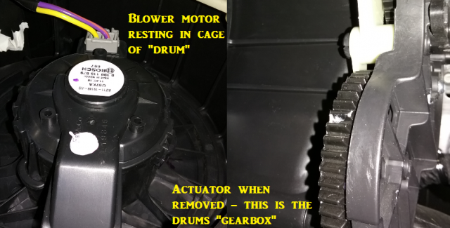

This requires some disassembly of the front dash and console all over again but look for and see if the actuator motor is able to move the "drum" within it.
The drum itself sits inside the air assembly, with the blower motor in a cage in the middle of it - the drum moves - rotates - and has a set of precut slots or holes - when you turn the climate control settings, air from the blower motor fresh from the Air intake control dam (Fresh outside or Recirculated inside) gets centrifuged to the space in the drum. The actuator which is located on the driver's side just above the throttle pedal - between the radio, the dash pods and the pedal, moves the drum to roate these ports for the vent system - aligning it's slots or holes to the holes or ports in the outer assembly that holds the drum blower inside - and the vents to the outside - to the passenger compartment. The drum simply moves, the holes either line up and you feel air commnig out, or they continue their travel using the actuator gearbox to align to another set of holes.
The Actuator is similar to the air-door actuator - and if the actuator was accidentally reseated in the wrong position and then a reset - you have to remove it, rotate the console controls thru their steps, and watching the actuator gear rotate as well, the direction of rotation, the length of time it does this, and where it stops in aspect of the climate control setting - you have to find its "home" then by physically moving the gear it rests and rides along with - find it's extreme stops and also feel the air blowing out of particular vents for a particular setting and then install the actuator before it forgets - so this has to be done with the engine running or at least in the ignition on and a battery charger to keep the system alive.
You may also have an issue of the drum getting stuck in a position

The only "bear" I had with the actuator - is in taking it off.
Uses torx screws and uses three - might want to remove the lower (below steering column) kick panel to let you have better access to the driver's side actuator. Just remember to lift and pop off the Air bag connector else you'll need resistors to "numb" the SRS until that can be fixed.
The wires to it - they use a snap-in insert, to keep the connector from dislodging - it's a lot like the Air Actuator one in the Intake Fresh/Recirculated. And uses similar sized torx bit for the screws (#15 I think) The Air is Red, the drum one is white or lite yellow - just lift the tabs to allow the press-in tab to release the connector.
That is if you just want to set it and forget it - for example, the MAX A/C setting versus the floor vent / top defroster. I've done that before, just move the gearbox to find a comfortable setting for air to flow out of the vents, to buy me time to figure out the mess that occured and then put it / align it - together right so I can enjoy "Climate control" again. But if needed or you just don't want to fuss more and save this for another day, just rotate the gearbox and let the air forced out in the blower let you find which set of vents to use for best results in summer and then just rotate gearbox for winter and then you don't have to mess with the actuator, period.

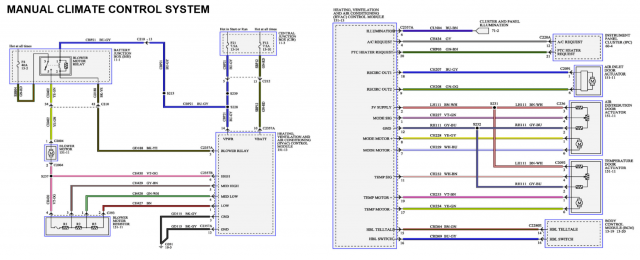

The Actuator turns when you start the engine - changing settings - nothing happens.
Replace the Actuator - more than likely the "stepper motor" cannot rotate in the opposite direction - they are supposed to rotate back to "Home" when you select "O" in the Climate control. So, the Gear turns but does not turn back tells me that is why it's stuck - the Drum gear has its own built in limit stop - so it doesn't just roll and rotate haphazardly so once the Actuator rolls the drum all the way to a limit stop - the gear won't let it go (rotate) back to home, that is why that is occurring.
Realize that you had to watch the actuator work and for you to try the controls to see if the gear would reverse - since it's not - the next step is replacing the actuator.
Since it doesn't roll backwards, there may be two issues,
  • The Actuators stepper motor is shot - only goes one direction
  • The LOGIC for the stepper motor system - the way it works, is bad, and needs replacement.
  • A third one can be the wiring is damaged but requires troubleshooting.
    • Did you see how many wires to the connector on the Actuator?
    • If only two - you have the Basic system - it reverses polarity in the connector back at the Climate control.
    • Three allow for reverse and follow
    • Four allows for stepper increment and back step - with follow and used for bi-level control
    • Let Me Rephrase this: The climate control head THAT uses a thermostat and temperature display to help - if that is the type you have, the logic control is bad for you won't be able to control or it (actuator to) follow user climate settings.

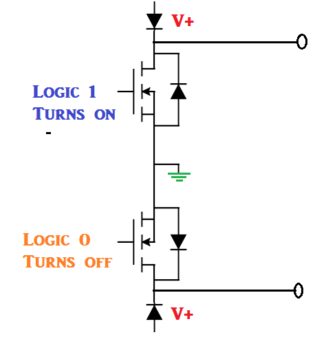

I'll try another actuator. And get back. It's a two lead connection, and cost me about $20 on eBay.
2,019
1,401
The above schematic may or may not help you in understanding how two wires can be made to reverse, but the idea here is to develop a way to reverse polarity without too much fuss in relay or toggles switches. Instead, they use MOSFET solid state to turn on one wire to "ground" and the other wire stays hot because the part the controls the other MOSFET on the opposite terminal is off so, power flows thru the terminal - letting the terminal remain at powered level thru the V+. while the other terminal is turned "On" and then sinks current - the V+ feed is sent thru a resistor to both sides (omitted to keep this simple) so they both don't blow up the part or force too much of the current thru the motor connected to these two leads.
So, when one part is LOGIC 1 - it turns on and ground appears so power flows from the other terminal thru the motor back into the MOSFET that is on, thru itself, to ground.
The turn that MOSFET off and turn the other one on - this completes the circuit again and the process occurs, but the polarity of it is reversed. The Motor turns in the other direction.
It's very simplistic but the concept shown, I hopes helps you understand how two wires can be made to make a motor run in reverse.
