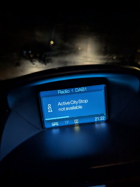

I have a Ford fiesta titanium x 2016 and Everytime I turn on the car this message pops up. Sadly I have looked it up but not found too much information about it. I have already checked the battery which is perfectly fine.
Any advice would be greatly appreciated. Thanks!
That feature was not available in North America. But I would recommend that you trace the circuit and check the quality of the negative earth/ground connection.

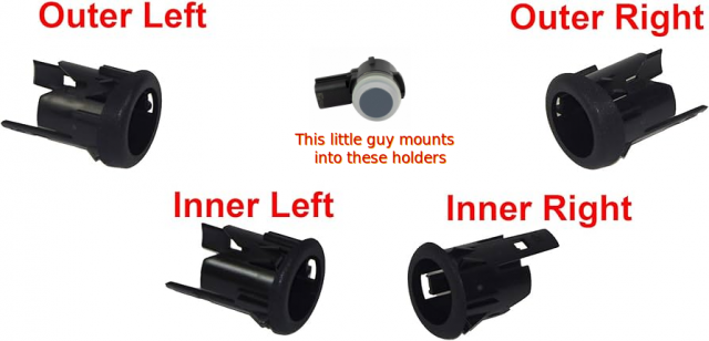

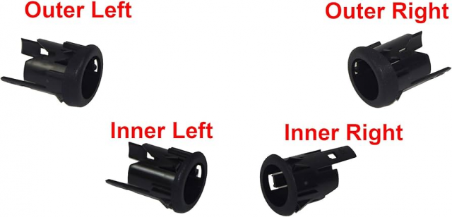

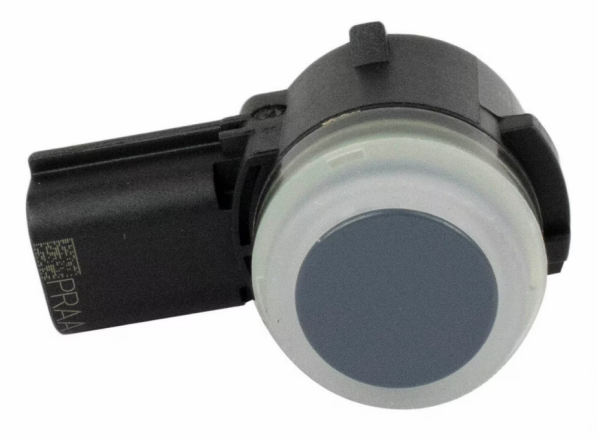

They can look like this...
...OR...
Look like this...
Mount in holes and are clipped onto the holder
...OR...
Look like this...
...OR...
Look like this...

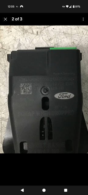

Thank you so much for all your help! From what I can see after looking at schematics and other examples of my car, I have bought this one (please look at photo)
From what I can from the website 7zap (https://ford.7zap.com/en/car/59/no/0/1843/16676/72590/)
I believe that I have bought the correct one. Hopefully this will fix the issue. Either way I'll keep you updated! Thank you!

Good afternoon! I have some fantastic news. It works! I plugged it into the car and the car recognize it immediately, I can now modify all the hazard spot warnings settings etc.
Thank you so much for all your help, this has been a quite fun experience
