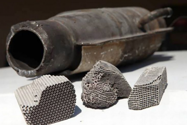

Another type of condition that causes this is when a lot of cleaners get used all at once on the engine - Carb Cleaner while the engine is running - another cleaner in the fuel system as an additive - and then several shots of another cleaner into the throttle body again while the engine is running - can make the Catalytic converters "honeycomb" a large pack of cement and it's due to the carbon now plugging the ports the exhaust flow needs to go thru to convert that CO to CO2 S2H4O into a lesser problem child - it can't when the catalytic is plugged with carbon.
This condition is similar - a main chokehold of older cars that oftentimes burn oil - do the same thing.
The problems are, when this part gets plugged, there are NO OTHER WAYS for the exhaust to go except thru it, or out thru a gasket that is located on the engine. This condition is called backpressure - in some instances, the engine stalls because the exhaust gases can't escape so they remain in the combustion chamber and even in the EGR valve in the automatic transmission types, is forced open by this pressure - the engine is an air pump - it can't pump if it can't push the air thru it.
Another is from the catalytic getting damaged by road debris, it can dent and crush or break the honeycomb structure that has the catalyst conversion metals that do the actual process - rendering it less effective so the system sees less of one type of fume in the exhaust, and more "raw exhaust" meaning that the O2 sensors are reading about the same value - tells the system to look for problems.
