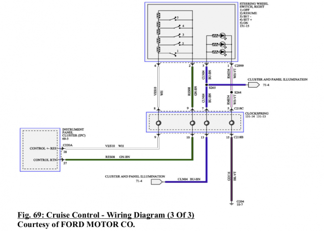

The two missing wires go from the Clock Spring to the Instrument Cluster (pins 27 and 28).
If I add these two wires, will I be able to get my Cruise Control to work? Or am I missing more parts? Swap BCM as well?

IN regards to the Clockspring - being that you have the main connector - the USA versions of this use a type of "padded" control button...
You only need 4 wires - two reserved for the lighting.
The other two which you seem to be talking about - the SOCKET side (the upper row of numbers) use 8 and 9 and the PIN side - the Lower row of numbers - 9 and 10 - but do you have the correct pad?
The Padded part is what is interesting - because it uses a set of dropping resistors that send a control voltage level per press - as the signal to tell the system what to do.
Including a High logic level to turn it off - but to turn it on, then requires a low-logic level above 0V but well below the Control RES signal - so it looks for a level of impedance that changes between the CONTROL RES and CONTROL RTN. When its at rest it's still active - but idle until you press a button - for all the resistors "sum" to a known low-value reference level - it's self zeroing - but when you turn it on (On button press) that raises the signal level and tells the Tell-tale light to turn on - the rest goes from there.

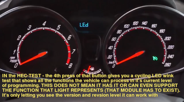

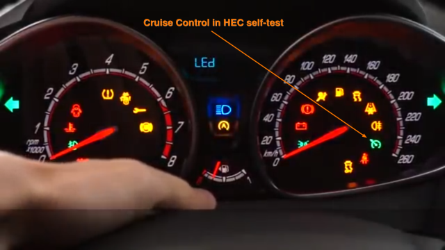

To help you know if you can even make this work is to go and place the Pods in a HEC Test mode and that will help you know if your vehicle will support the Cruise Control upgrade or not.
In the Fiestas with such a IPCC setup - the 3-rd button-press brings up this all lights test...
As discussed in a previous post in this thread, you will have to know if the Light and it's symbol for it is even present on the DASH panel. How? You use the HEC test mode to light up test all the lights on your Instrument Panel Cluster in both pods to find that symbol.
If you have the symbol in the "all light test" portion of the HEC, then it's highly possible you can install the Cruise Control - just be ready to shell out some $$$ to find a FORSCAN revision that will be backwards compatible to the year of your vehicle and be able to find the Address (in the Modules they use CAN BUS to address and call out). So each module is addressed by either a name or in the module - an actual hexadecimal address - not only for the programming to work, but as an means to ENABLE or NOT_ENABLE the function so the system can "tie itself" to it using the on-board programming and system calls it needs to have to make the PCM work autonomously with the IPCC and that specific area of programming to make the Cruise Control and Throttle work with the sensors it has and can see.
