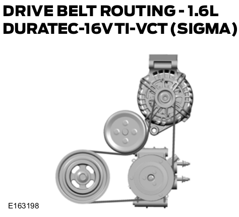

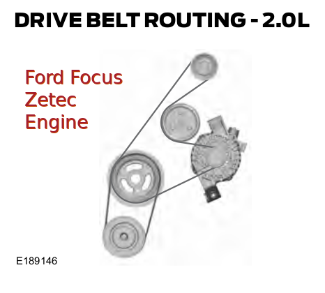

Back when (before while the car was in production) they tried ways to delete it. They found one idea that worked, but it required you use an idler roller they had used on the Zetec motor used on the Focus to take the place of the AC pulley was, with smaller length belt size to offset the changes the new smaller pulley made.
I've done a delete to a Scion xA - much easier and far more worthwhile - the AC developed a leak thru it's lifetime so the pump was pretty much shot after about 4 years of refilling and trying to use it for summer. The pulley was on the serpentine so it eventually affected and damaged the water pump so all of the components on it's belt path had to have something done - after taking off the AC it was easier to get at the water pump and so when it was put back together I left the AC off the car, removed the hoses and was able to use a smaller belt because the Alternator mounting "bracket" and pivot Ear was able to be used to apply tension on the belt and the engine seemed to have run far easier and cooler without the AC pump - so you're preaching to the Choir here...
But, that does not help you when the Water pump, Alternator and AC have to be in the alignment and position they are on the Sigma motor the Fiestas' used past 2011-12 model year (USA). Due to their pulley to belt travel - you don't have much to work with...
Aside from the fact that the Alternator by position alone interferes with pulley to belt travel due to the water pumps location when you try to remove the AC.
On the Scion, the AC appears as the "Add-on" so they simply stuck it as the base of the motor over by the oil pan level - the Sigma motor does the same - but the water pump pulley interferes by size (diameter) to accomplish this delete thing which requires you to use the idler pulley from an older Focus Zetec motor they put in there to accomplish the clearance - only they did relocate the Alternator as a swap to replace the ilder on the Sigma motor..
