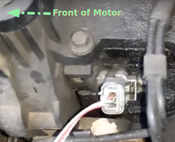

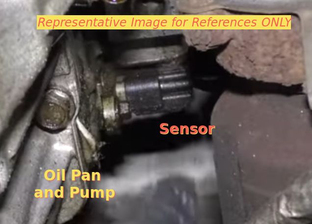

The "firing" timing signals are generated during the crank signal - so this may just mean that you'd have to go under the car and check to see if the Front pulley (Balancer) crankshaft position sensor isn't damaged. Its by that front belt and see if the belt itself didn't gouge or damage it's connector when you had to work on the car. Back side of the harmonic balancer - the little wedge shaped box should be it.
