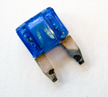

You just might need a little TLC around the battery and power connections - even fuses - they are not infallible and are left in an environment similar to the engines all the time - so they are subjected to the heat, moisture - vibration - would not hurt to check and pull fuses to verify that their terminal connections are still working.
That's pitting on the lower portions of their legs,
Caused by corrosion - eventually causes intermittent
failures then it will literally plug up the terminals' socket
forcing you to tear apart the block and remove the debris.​
I've had fuses in older SUV's that fell apart and left their "leg" at the terminal - corroded away - due to the environment and their age.
